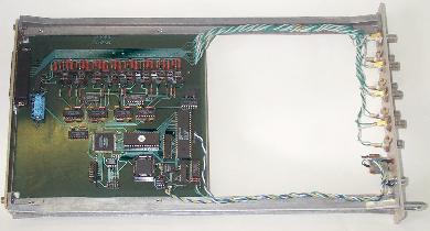

8-channel pulse-width converter (detail description (3-feb-2003) in pdf file) is intended for replacing obsolete CAMAC modules PKS-8 which were used in our control systems. The device generates bipolar pulses where a time between start and stop pulses is defined by code.
Parameters of CPKS-8:
- registers size - 16 bits;
- output channels – 8;
- output voltage 12-15 V;
- output pulse duration 300 nS;
- terminator resistance - 75 Ohm;
- time quantum - 100 ns.
