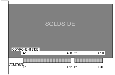

HwB: ISA Connector
ISA
ISA=Industry Standard Architecture
(At
the card)
(At the computer)
62+36 PIN EDGE CONNECTOR MALE at the card.
62+36 PIN EDGE CONNECTOR FEMALE at the computer.
